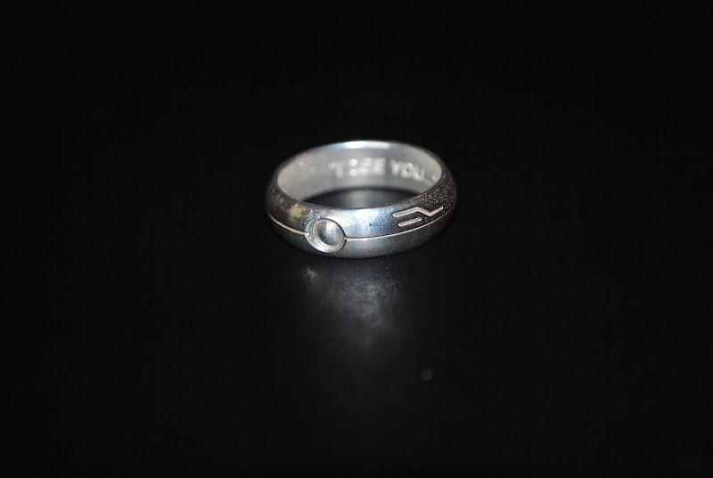

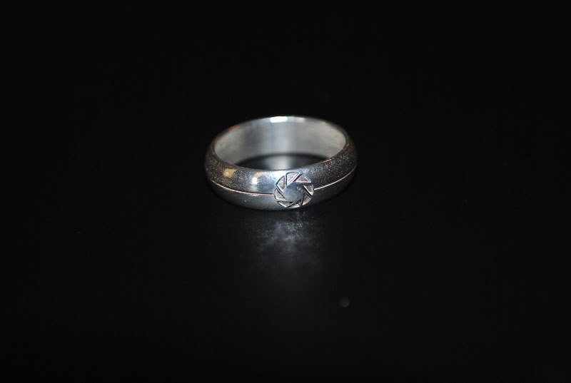

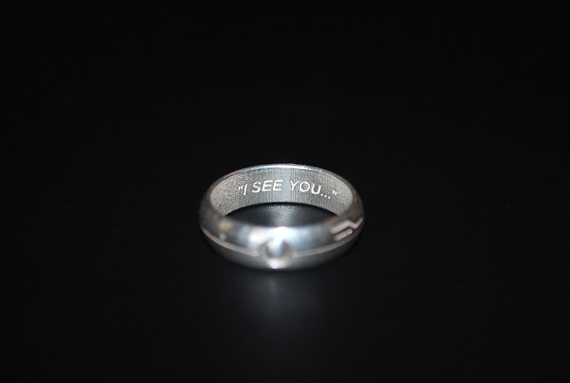

Sorry for the wait ( I don't own a camera so I had to borrow one) here are the unpainted pictures. I polished it a bit but not to a mirror finish as it is getting painted after all.
https://lh4.googleusercontent.com/-0xjpK8iDF9k/TmUK30-bQpI/AAAAAAAAED8/WQ2nKSAhmy4/s800/DSC_0279-1.JPG
https://lh4.googleusercontent.com/-bsRGet7rOZw/TmUK4fKtMsI/AAAAAAAAEEA/xwmqhcjfhws/s800/DSC_0277-1.JPG
https://lh5.googleusercontent.com/-6LT2EeNrYZM/TmUK4tXZA2I/AAAAAAAAEEE/-XSM_XFDcSg/s800/DSC_0274-1.JPG
