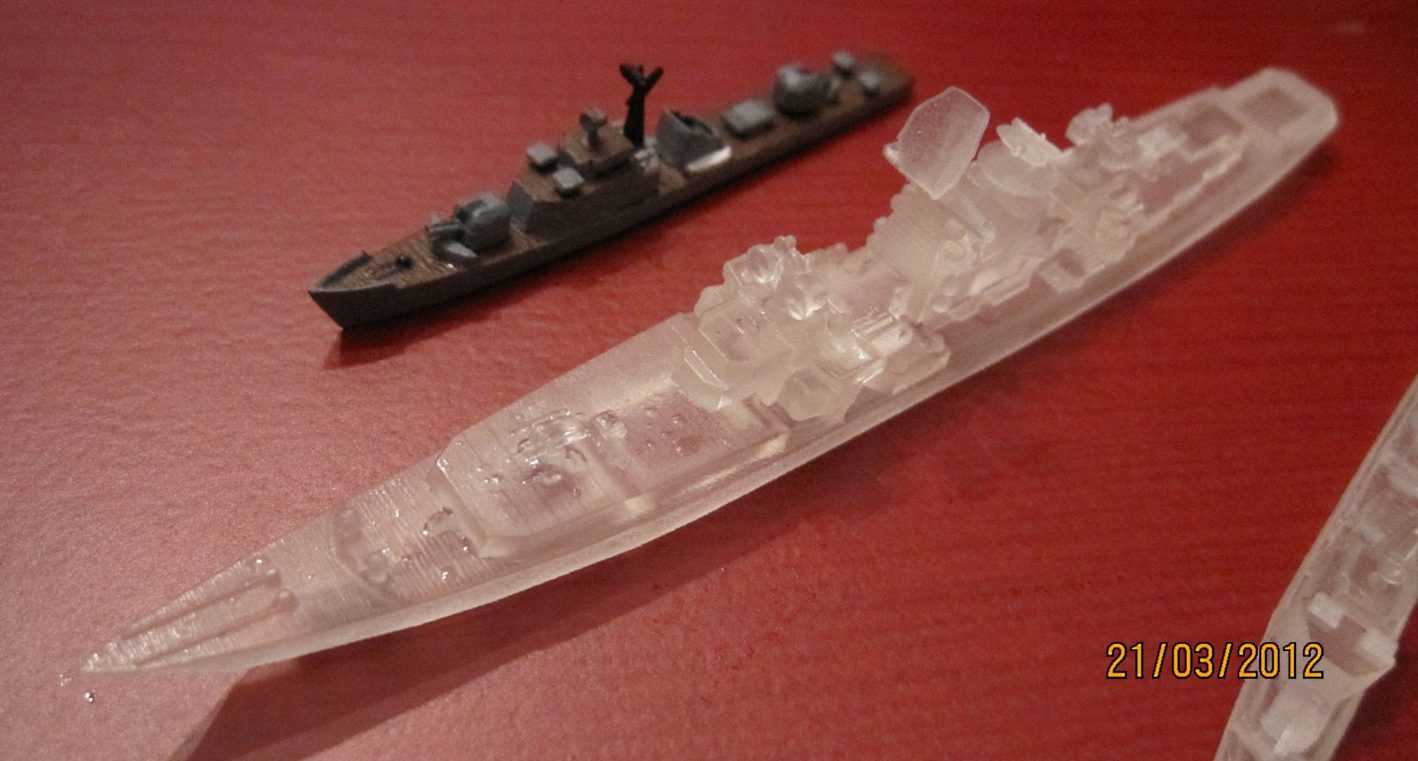

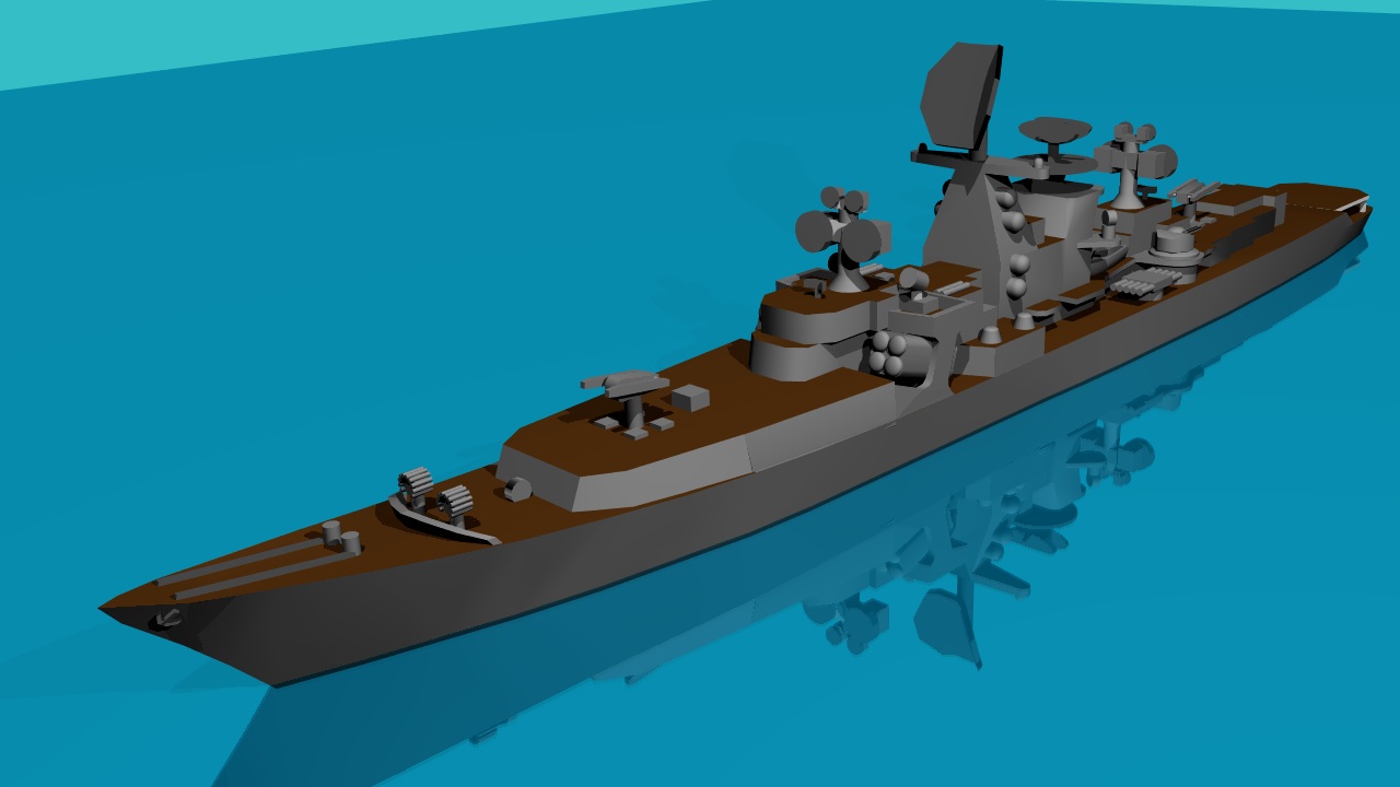

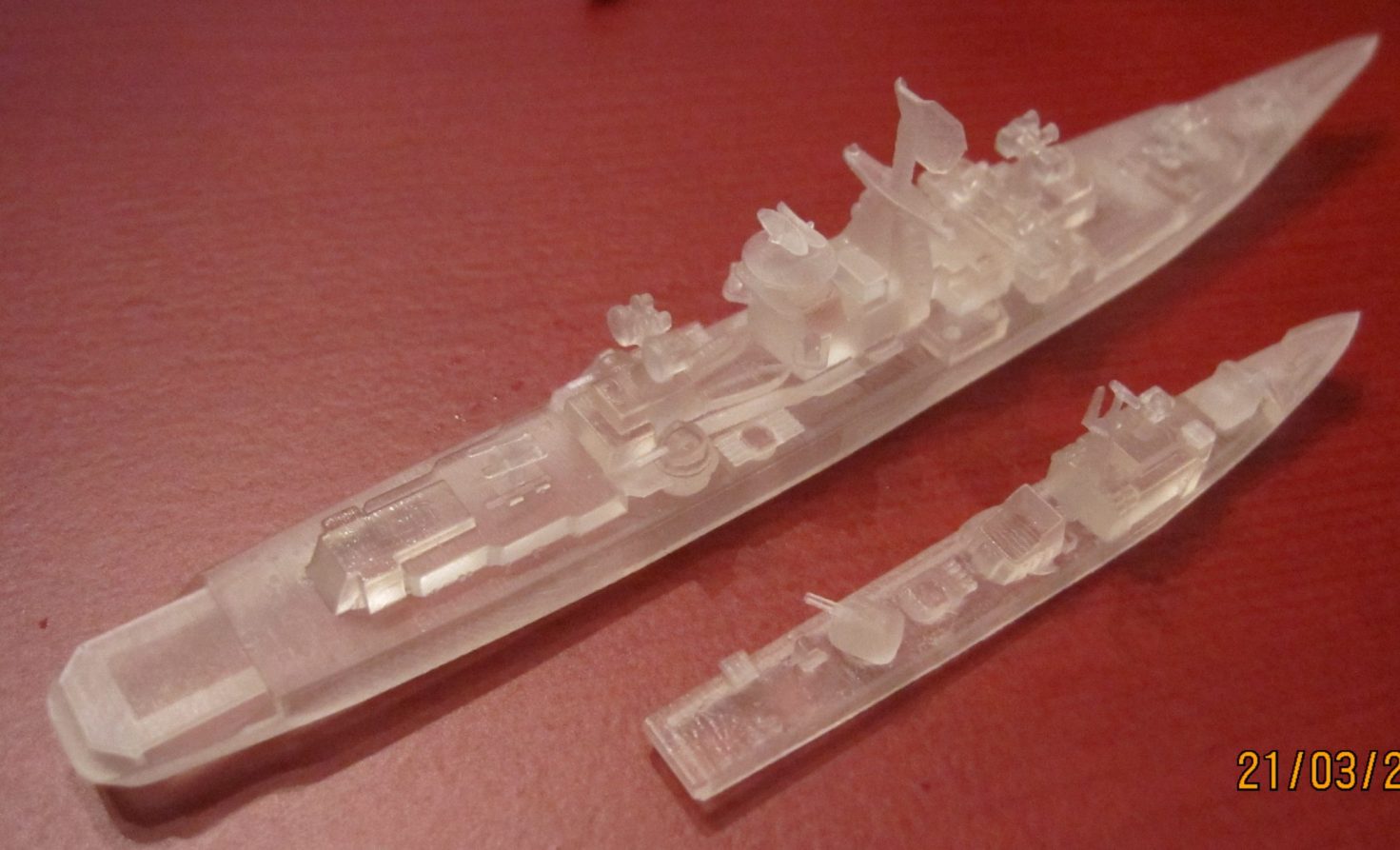

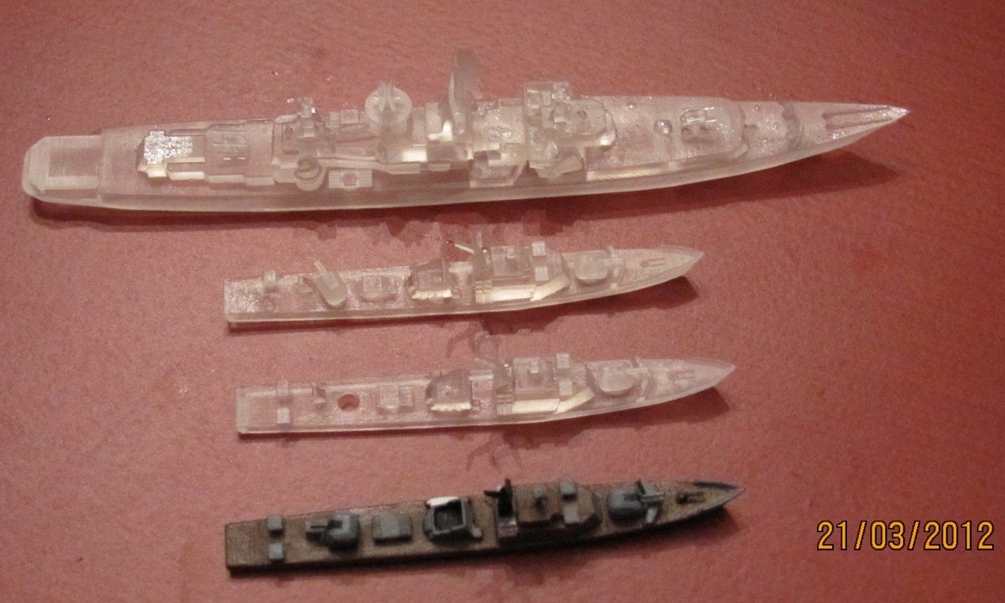

My second ship model
1/1250 scale Soviet Kresta 2 class cruiser from the 1970's
- this one is twice the size of the Petya, about 12cm long
and took me 4 times longer to make because of all the extra details.
Render from 3D Crafter
http://www.borisbear.freeuk.com/k2a.jpg
I am so happy with the result.
Stunning detail, down to the gun barrels (0.3mm)
Along with my updated version of the Petya, which also printed better this time.
I had attached the turrets to the model this time but still only 3 of the 4 arrived Sad , none were attached - another mod needed.

Beautiful ships! Did you have any trouble with paint sticking to the model? Did you clean it before you painted it and if so, what with?
Re: Good and not so good [message #45859 is a reply to message #45848 ] Fri, 23 March 2012 08:18 UTC Go to previous messageGo to next message
avatar decapod  is currently offline decapod
Messages: 28
Registered: January 2012
I dunked them in a glass with hot water (not boiling) with some washing up detergent. (Ecover in the UK as it has fewer extra chemicals)
Just for a couple of mins.
Gave them a light brush over with a dry paint brush and left to dry completely.
This brought out much more of the detail.
Tamiya Acrylic paints seem to be sticking well but requires 2 coats (more a problem with the paint than the material)
