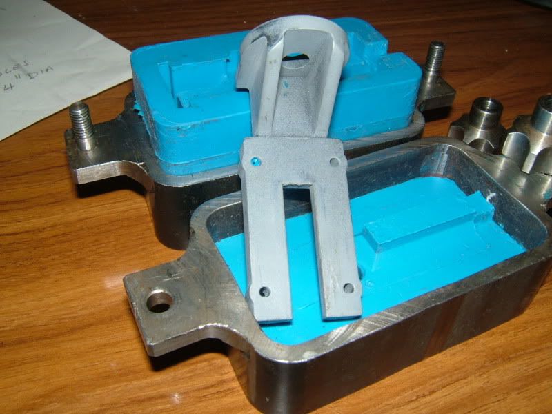

You can make silicone moulds from any of the printed materials but beware.
Some silicones can be "poisoned" by extraneous support media left on FD and UFD models.
This media is very difficult to eliminate and can result in small sticky areas where the rubber has failed to cure.
Choice of silicone very important and you should consult with the supplier.
WSF has given me no problems with silicone curing , but the surface roughness can make mould stripping difficult.
Painting with primer and flatting where possible will help as with this pattern for a 7 !/4" gauge steam locomotive part.
http://i41.photobucket.com/albums/e279/CPTABDAB123/DSCF4188.jpg
Polished WSF is easier to strip , as you would expect.
