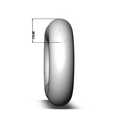

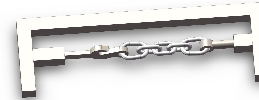

nancyliang wrote on Tue, 09 August 2011 04:27
I added some additional guidelines for wires within 0.3-0.6mm that would make them stronger.
Nancy
I have been reading through the design rules for wires and have an additional question/comment:
What about if you design a chain? Like in the picture:
http://i833.photobucket.com/albums/zz254/Olovsson/Skerhetskedjafr3DprintV40.jpg
Does in that case the wire need to be square for 0.3 to 0.6 mm? Or will it work like it is drawn in the picture. Diameter is 0.3mm in this case. The ratio is well within 1:30 (1:20).
Anyone with experience of chain designs in FUD?
Kjell

Paul,
I had a look on you designs and you certainly have a lot of experience in "chain design" Smile
I was a bit unclear in my previous post. What I mean was that the wire that "builds" the link is 0.3mm in diameter:
http://i833.photobucket.com/albums/zz254/Olovsson/link.jpg
Question is how the design rules would look like for a thing like this. The rules really don't cover these cases today (at least in my opinion).
Kjell

yep Kjell, that's what I'm meaning too, but looking at the 'wire' as a mesh, is the 0.3mm a face-to-face or a point-to-pont measurement? Depending how many faces there are in the circumference of the 'wire', if the measurement is point to point, you'll have sub 0.3mm face to face.e.g.
http://www.stop4stuff.com/shapeways/images/0.3mm-point-point.jpg
I don't think there'd be an issue with your design as long as it meets the 0.3mm wall thickness rule, (I tend to think of chain links as rings rather than the wire that makes up the link.) You could always upload the model, and send Shapeways Customer Service a message asking for their opinion as to the printability.
Paul

Paul,
Now I'm with you.
Actually this is interesting, I myself didn't think of it in this way. You actually get a different "wall thickness" on wires, from what you have in the CAD program when you generate the STL (or whichever format you are using) file.
So in the case with the link in my picture above, the thickness will certainly be a bit less than 0.3 mm. How much less must be depending on how "tight" you generate the triangles in the STL file.
However this is easily fixed with a wire that is drawn some 1/100mm thicker in the CAD program, how much thicker it should be needs probably to be tested.
Thanks for making me aware of this and it would probably be good to mentioned it in the design rules.
Kjell
