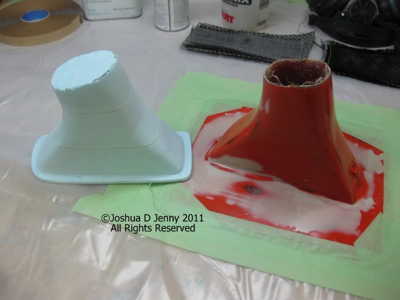

I am an engineering student who seeks outsides ventures in the world of motorsports in my spare time. I am currently building a BMW M3 for the purposes of road racing and tarmac rallies. I have been developing this car for 2 years and I have recently entered the world of composite fabrication.
Among many other projects, I am currently in progress of developing several air inlet ducts. I have been going about this in a more primitive way by shaping a moldless design via foam, laying over it, dissolving my foam, and then laying material on the inside of my piece as a re-usable mold, made of fiberglass strand mat/resin with a gel coat finish. This is working out pretty well, but since I have found my introduction in CAD in the past year, I can't help but want to be 100% precise. A friend of mine recently told me of 3D printing and I am hoping that you guys here can help me determine if this would be the best way for me to create a perfect product.
I would be designing the product in PRO Engineer software and then using the actual piece here as an internal mold.
Here are some photos I have of the process so far so that you can get the idea of what I am trying to accomplish. I am working out some kinks in my original design and also making progress in regards to obtaining an optimal finish in my composites fabrication. That said, I still have some work to do in turning out a perfect finish so let's not focus on that, but i regards to creating the perfect mold, please advise. I am investing quite a bit of time and certainly a brake duct does not need to be 100% perfect in regards to its aerodynamic efficiency nor its aesthetic features. But if it can at the product of me furthering my CAD abilities then I am all for it.
Also, I am aware that in the world of one-off production this is not likely the most cost effective. I am working to develop these pieces to be something that it is marketable, among other pieces swimming in my brain.
Thanks!!!
http://i21.photobucket.com/albums/b297/328ischef/7f58b942.jpg
Original foam prototype versus polished mold ready for use.

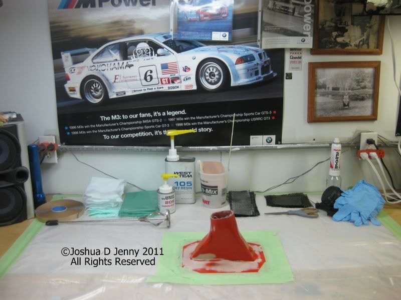

http://i21.photobucket.com/albums/b297/328ischef/fe7d6532.jpg
Ready for duty.
