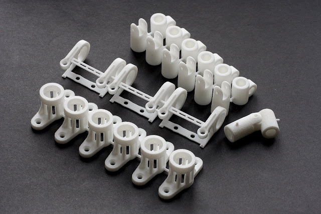

Arrived today, really fast turnaround. My first print ever, I'm very impressed. No exclamation marks will do justice so I'm not using any.
I'm pleased that the parts, where their dimensions are imperfect, are imperfect to the fat side. Shaving a bit off here and there is not a problem, that's nice. Worth noting that the inner holes (6mm dia) are not even round at all. Fixed that with a drill bit.
Pics.
The whole batch:
http://lh4.ggpht.com/_iQz8NSIO4Xc/S7YWyEF5qMI/AAAAAAAAHHg/_VLLU7KqkSo/s640/IMG_5249.jpg

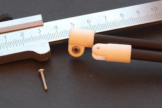

Bearings inserted:
http://lh5.ggpht.com/_iQz8NSIO4Xc/S7YfzA4qgtI/AAAAAAAAHIA/3iodCnrJt84/s640/IMG_5250.jpg
Assembled hinge:
http://lh5.ggpht.com/_iQz8NSIO4Xc/S7YfzwXvIZI/AAAAAAAAHIE/cZ0Lj-8pSps/s640/IMG_5251.jpg

2 mm ID, 5mm OD, 2.5mm thick, two in each piece. They can be found on ebay, in a specialized store or in an RC shop. Needless to say, avoid RC shops by all means.
