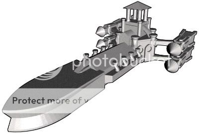

1. Modeled in Blender
"Gothic Destroyer Render":
http://i871.photobucket.com/albums/ab273/afrodri/Gothic%20Spaceships/10-DD-r2-1.jpg

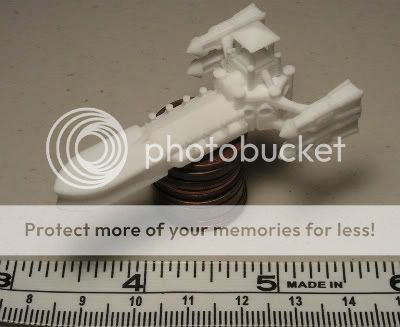

2. Uploaded the model and had it printed in the WSF
Printed "Gothic Detroyer" Model:
http://i871.photobucket.com/albums/ab273/afrodri/Gothic%20Spaceships/PICT0030-1.jpg

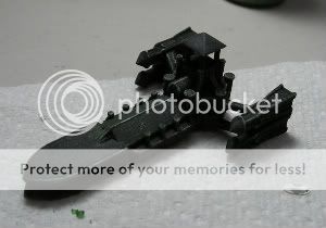

"Gothic Transport" after dye:
http://i871.photobucket.com/albums/ab273/afrodri/Painted%20Minis/PICT0061-1.jpg

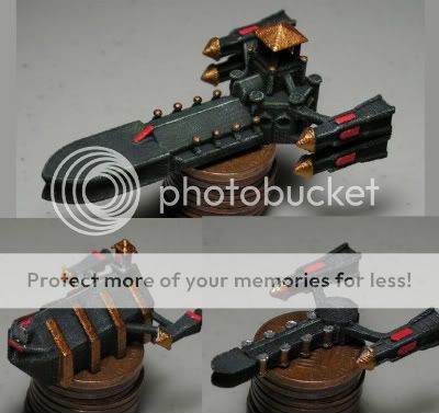

6. Lastly, I added detail with various metallics and red. Like many models, putting a precoat of black under the metallics or white/pink under the red helped them stand out.
http://i871.photobucket.com/albums/ab273/afrodri/Gothic%20Spaceships/FG-T-CA-1.jpg
